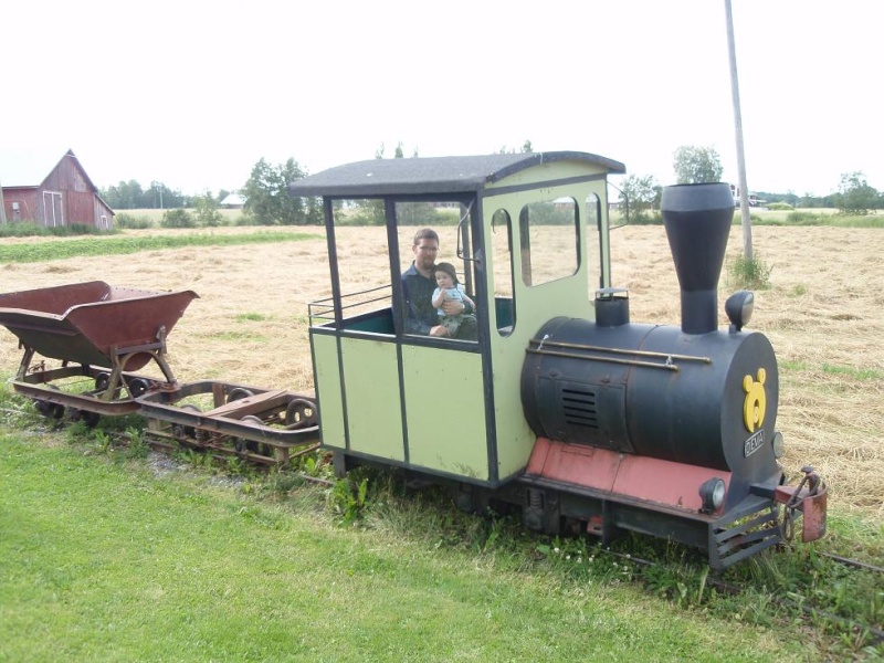

A picture of the locomotive that is steamlocomotive look a like at this moment. I have plans to change it back to original look.
At this link You can se a picture of the locomotive in original condition.
Diema DL6/3 in Komu Finland (picture 1)
Diema DL6/3 in Komu Finland (picture 2)

I would keep the lok in this state.
It is a unic Diema, there are no others like thisone.
And special builded loks are also a kind of history
so; why the changing??

Well I have been thinking like You for some years already. It is of course kind of special like it is now but it would also be great to have a small loco like Diema DL6. It is really hard ti decide what to do. Best of all would be that if I could find an other small loco.
